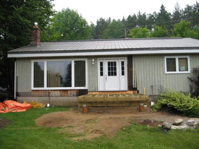

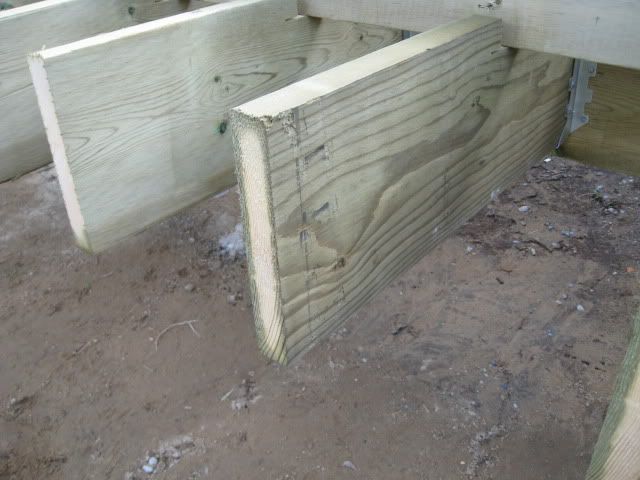

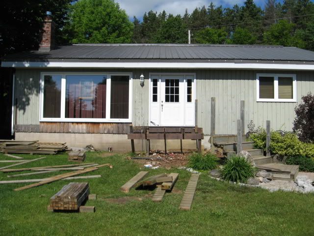

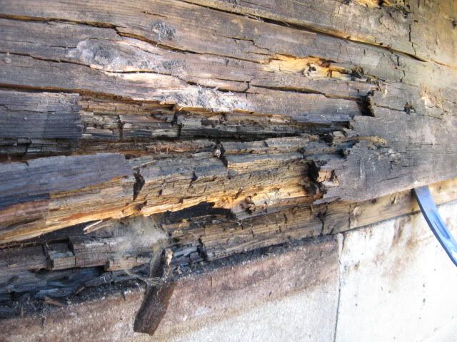

    Day 1.
    Here’s what I’m starting with…..nice eh?

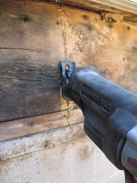

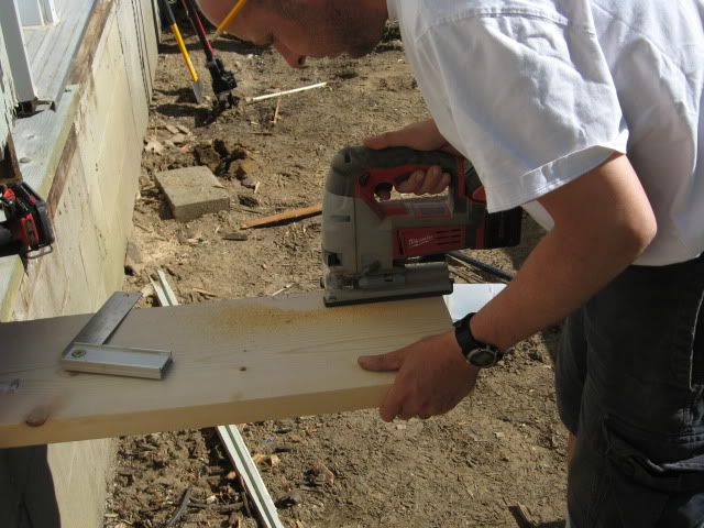

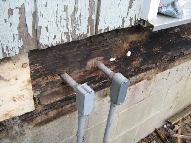

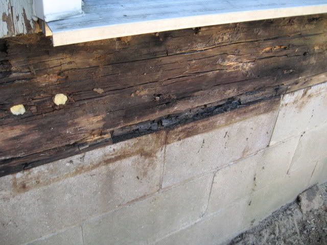

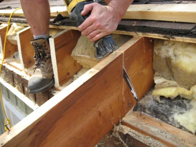

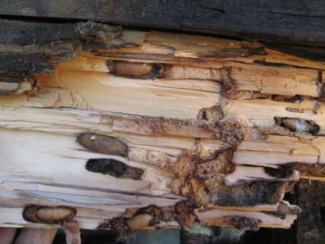

    So after ripping off/dismantling the front deck, I killed the 100000000 carpenter ants that had taken up residence in the rim joist, removed the rotten wood, and one at a time, replaced the floor joists that had rotted. The new 2X10’s had to be notched to match the dimension of the old ones.
    And twisted into place
    Finally, a new rim joist was added
    And that is enough for one day. 9 floor joists, 12’ of pressure treated sill plate, 12’ of new rim joist……time flies when you are having fun.

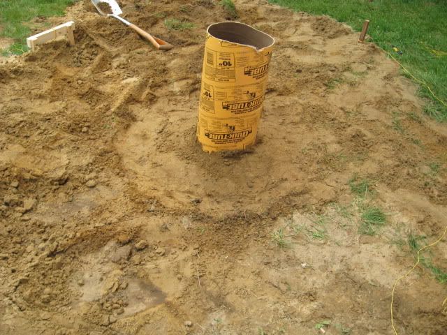

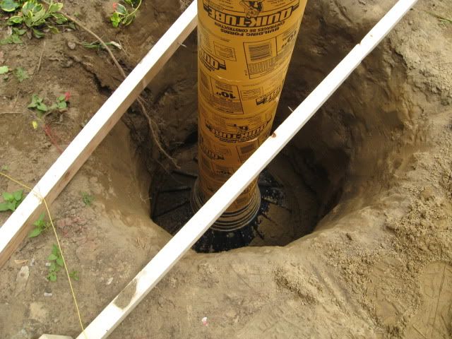

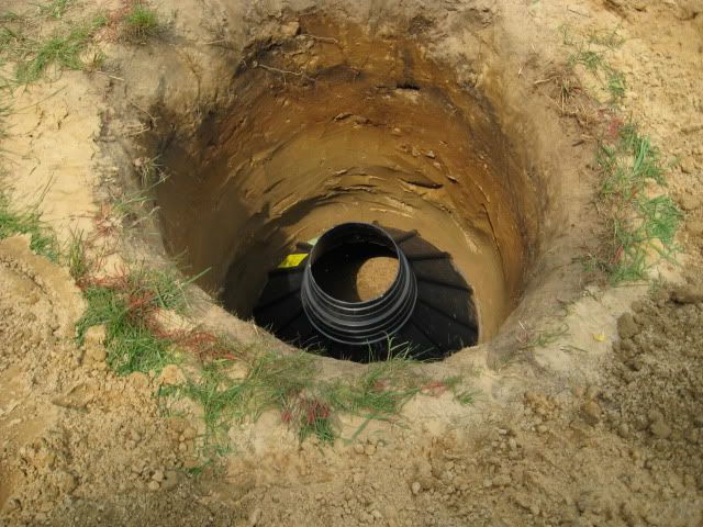

      Day 2 is all about digging….and digging…..and more digging. (too bad the temps were in the 30’s) I had to dig the footings for the new deck. The holes were 36” in diameter and 4’6” deep…..all dug by hand. (Hint: A really short shovel helps when you are chest deep in the hole)+
      A test fit of the big foot

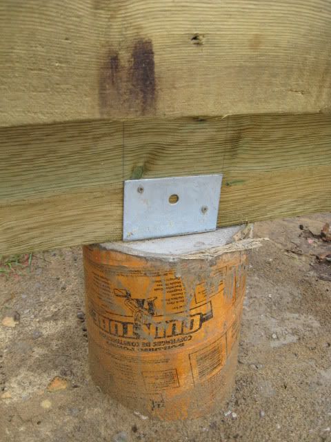

      The 10” sonotube was added and plumbed

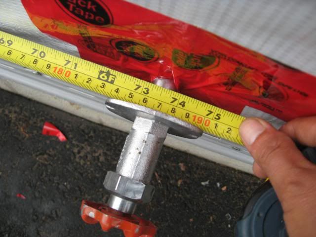

      The building inspector was called to inspect the hole, check for water, check for proper footing size and depth, and then I had to shovel all of the dirt that I had just dug OUT of the hole back IN to the hole…..good times.
      The late afternoon was spent mixing 20 bags of concrete and filling the two forms. Sorry no pics, but just picture a dirty/sweaty Ryan with a skid of bags, a hose, a rental mixer and a shovel.
      That’s MORE than enough for one day…..next up: Framing.

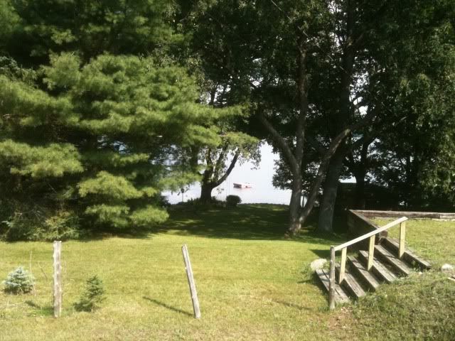

        I actually bought it for the view..... I built the shop a few years later

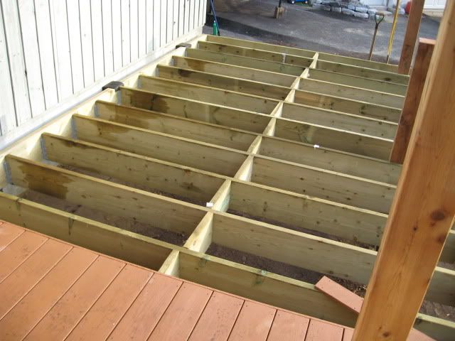

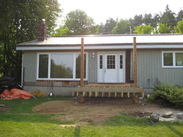

          Day 3:

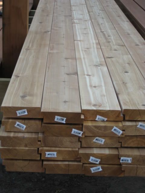

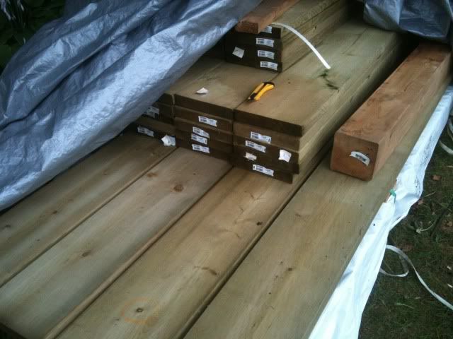

          The first step was to uncover the load of lumber that the Lowe’s truck dropped off….as I said in an earlier post, the nicest PT lumber I have ever encountered.
          The main beam was set onto the 10” sonotube, and screwed in place. No bolt yet…that’s coming up.

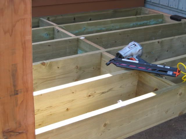

          The 10X10 upper portion was framed (2X10’s, 12” centers) and blocking installed midway along the length
          But it still needs some stairs….
          The first stair will eventually turn into a second freefloating deck, so it was built the same as the deck itself.
          And the 6X6 cedar uprights got notched to saddle the beam
          And the posts put in place,
          Tomorrow is decking and the fascia gets some surgery

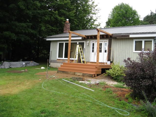

            Day 4

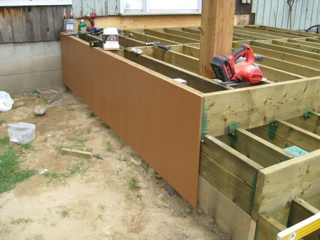

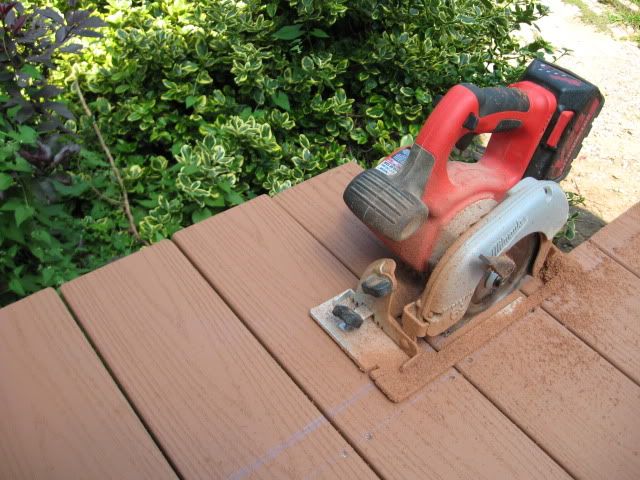

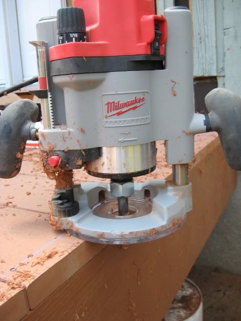

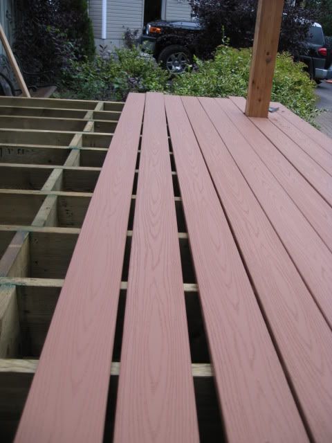

            The first thing was to lay the decking so I could have a place to work. Because I’m only building this deck *once*, I decided to go the PVC route for decking. I googled the heck out of the internet, hitting the pro contactor forums, the deck forums, the building associations, etc. etc. etc., all in the hunt for the ultimate deck material and there was one very clear winner. This decking is called Azek, and is really excellent stuff. It works almost identically to wood, takes router details, rips cleanly, and best of all: It will never, ever rot. There is no wood fiber like there is in composites, and the stuff is super hard. You can not get it to mark, even trying to deliberately gouge it with a key. I have some scraps if anyone wants to try for themselves.
            I attached the cover boards

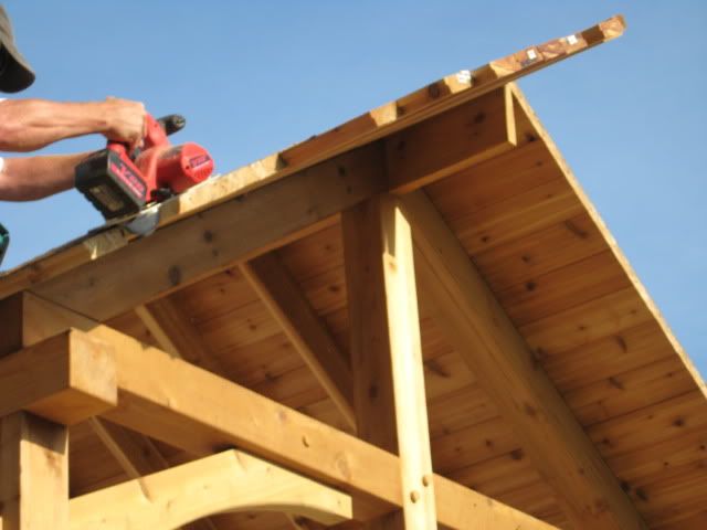

            Then laid the decking and trimmed it about 3/16” from the edge with my circ. Saw
            and routed it flush using an upcut spiral flush trimming bit. If you don’t have one of these, you need one……zero catching of the cutting edges, and because it shears, it cuts really smooth.
            Last step of the day: Cut back the Fascia and install the 6X6 cross members that sit on top of the posts.
            Next step: Post and beam

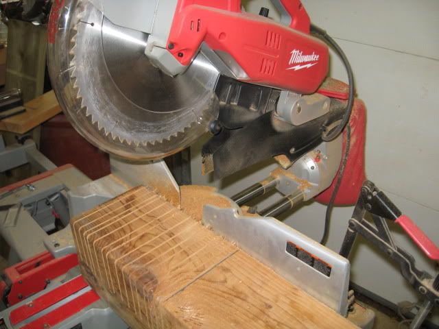

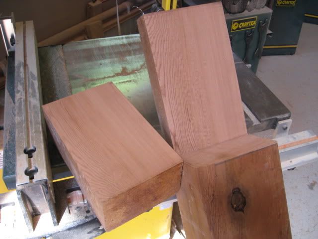

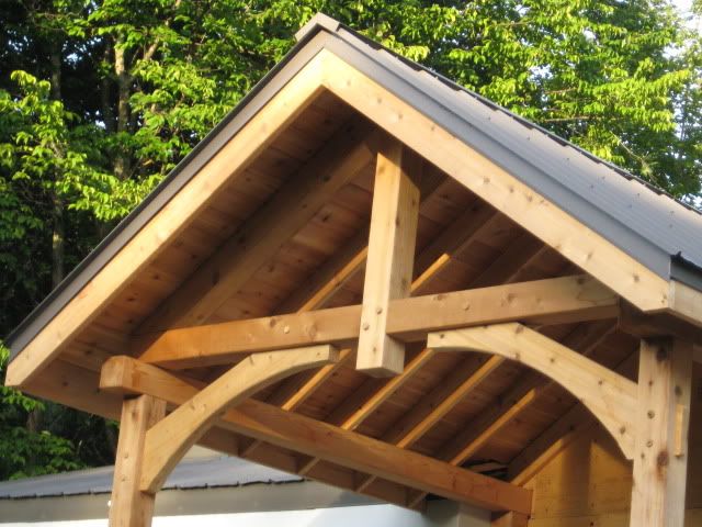

              So the first thing I needed to do was cut a 6X6X9’ wall tie, cut a half-lap, match it up with a 40” vertical and peg it together, and get it up in the air…..by myself…..lots of fun:
              Then cut the main rafter beams, brought them up one at a time and pegged them in place.
              And it starts to look like this:

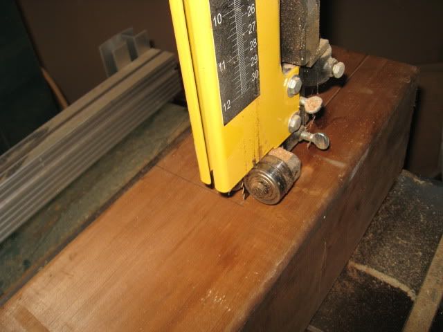

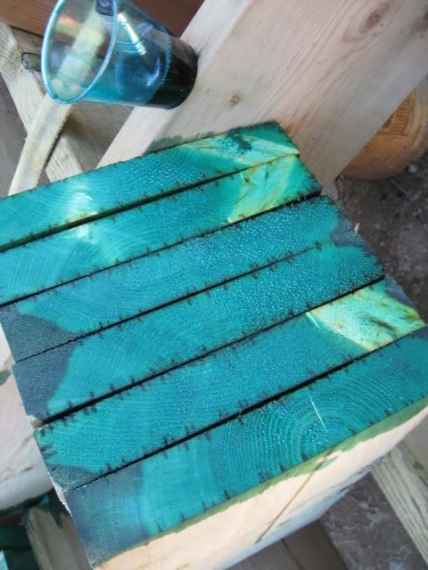

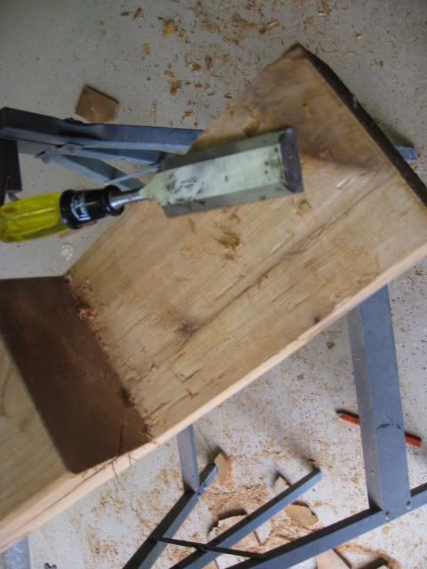

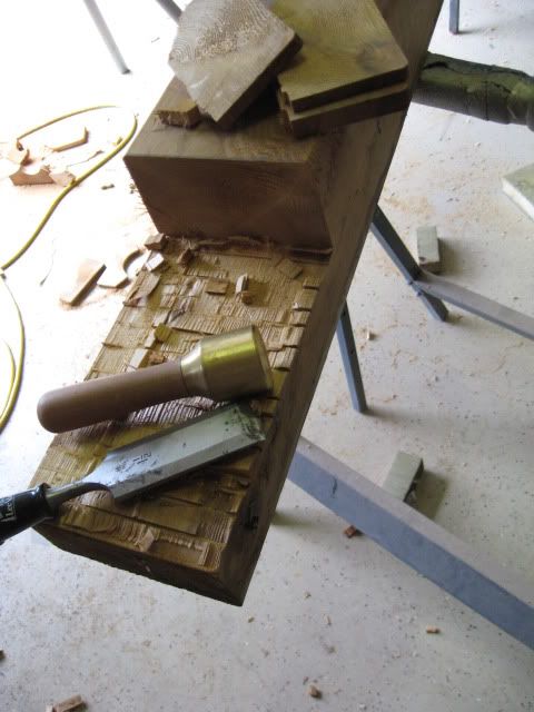

              Now…what do you do when you need a couple of 3”X11”X 4’ chunks of red cedar, but no mill has any? Joint, plane, and laminate four 2X6’s of course
              Get out the pencil and the Lee Valley drawing bow, mark out some tennons and hit the bandsaw
              A little hand work, a couple more pegs, and voila: Knee Braces

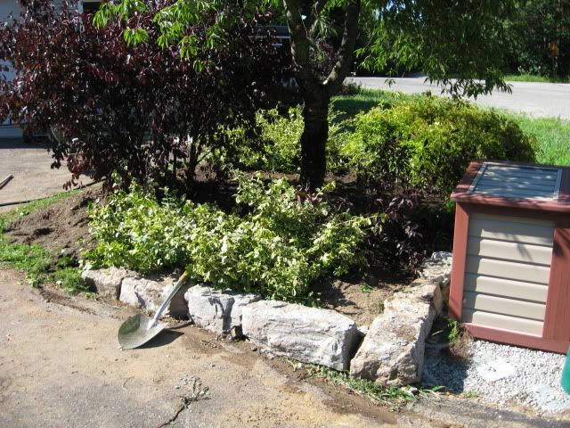

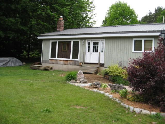

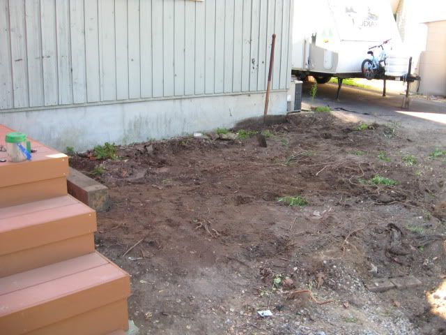

                Before:
                The garden, retaining wall, etc. were removed.....
                And relocated beside the drive:
                Sadly, that was it for day 6.....But I'm uploading day 7 now .

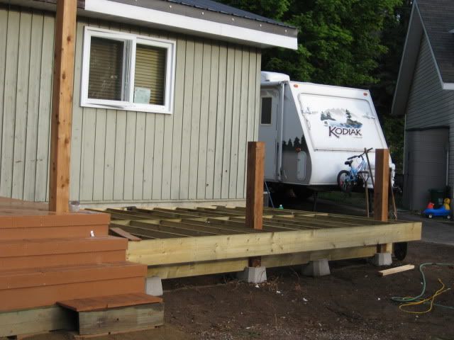

                  OK...Day 7

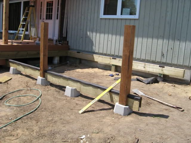

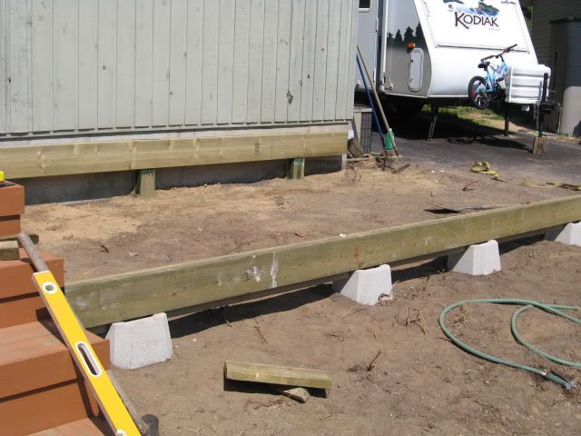

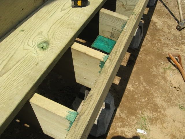

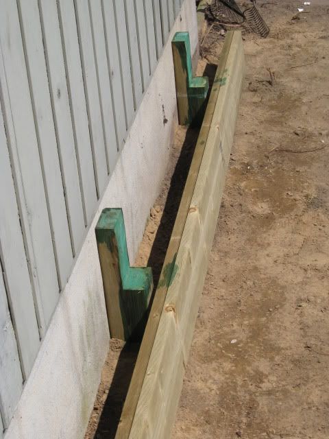

                  The first step was to dig down to the house footings in three places to the right of the new upper deck, then sit some notched 6X6 PT down on them before backfilling with gravel
                  And then set and level some deck blocks and a beam
                  So its pretty obvious that I'm doing a second deck by now

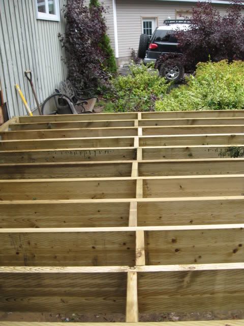

                  This is a free floating deck, about 12X16' set off the first step of the main deck. There's more to this, but you'll have to wait unil later to find out the "twist"

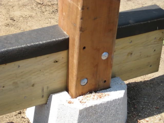

                  With the double ledger set on the footing posts and the 2 ply beam set on the blocks, it ws time to notch some 6X6 WRC to straddle the beam and sit into the blocks. Who says a band saw isn't a "deck building tool"?
                  The posts were cut to length, set in place, checked for plumb and bolted in place with some 1/2" X 7" galvanized stove bolts.
                  Then framing. 2X10 PT...some blocking....nothing real exciting.
                  And thats it for another day. I'm going to switch gears and go back to the main deck for a bit in day 8.

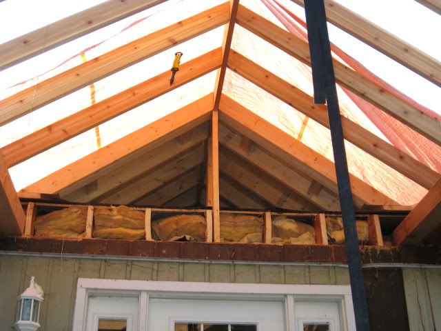

                    OK...Day 8.

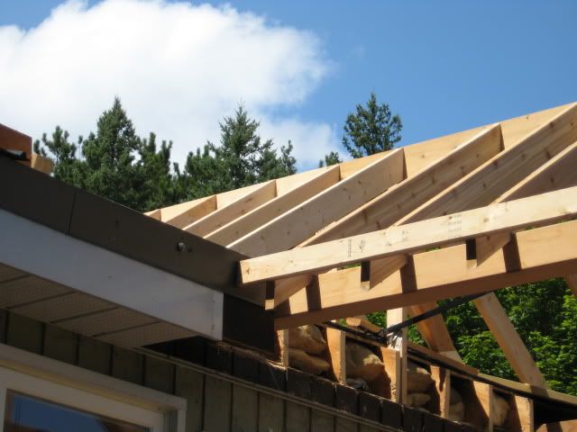

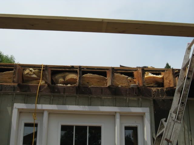

                    I started off the day by removing the existing steel roofing over the entry area....

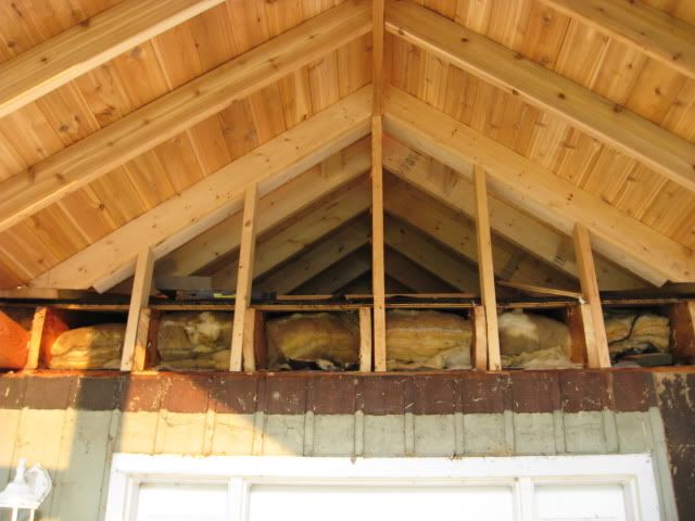

                    Then I needed to remove the tails of the existing rafters, cutting them flush with the top of the wall.
                    A temporary king post was nailed in place, and the ridge beam re-installed and plumbed. The gable rafters were cut, and then after laying some 2X10 strapping in the valleys to support the 36" W flashing I'll be using, the back rafters were cut and installed.
                    And tarped for the day

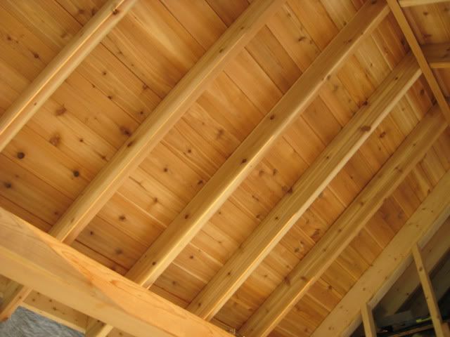

                    My last job was to make up the 2X lap cedar I'm using for the roof decking. It was made up of cedar 2X6's with a 3/4" X 3/8" rabbet down each side....There are 30 boards, 12' long, two rabbets each. If you do the math that adds up to 720 feet of rabbet! (and although Mr Schwartz may find rabbeting shelves useless on an a jointer, I'm certainly glad mine has one Running 12' long lumber and cutting rabbets that large in a single pass is no easy task for anything less than a power-fed shaper, but the Jointer did it no problem. )
                    Next up: Finish framing the gable, get those lap boards up, ice and water shield and getting the steel installed.

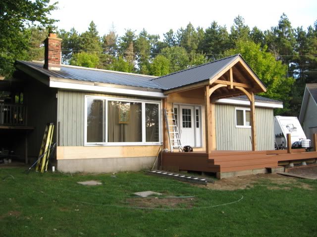

                      Day 9......

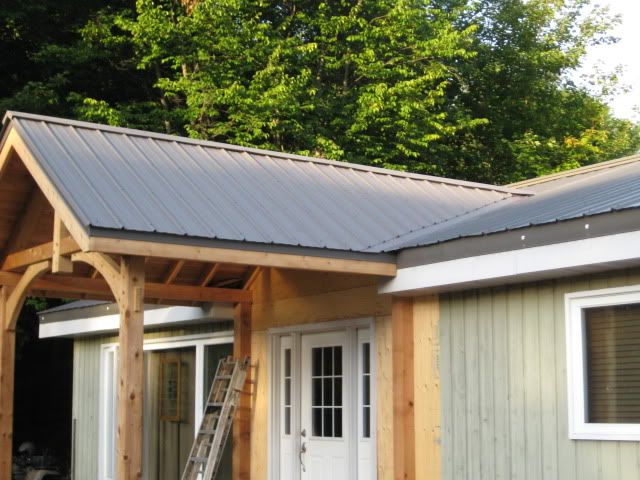

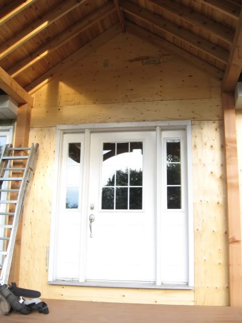

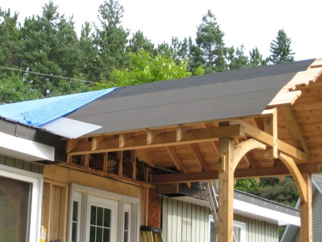

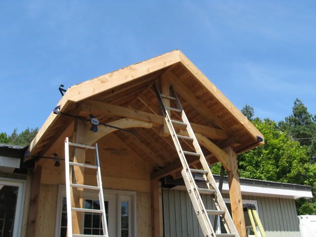

                      With the trusses framed in, I framed the gable wall and then it was time for sheathing. The front (visible) portion of the roof got the 1.5" shopmade shiplap cedar, while the portion behind the gable wall was done with plywood and strapping.

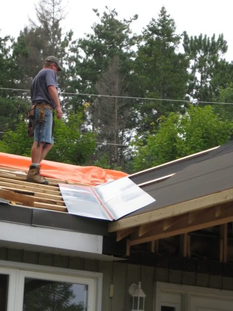

                      Because heavy rain was expected, I applied ice and water shield to the entire roof so I could avoid having a swimming pool in the living room, and so I could have a dry area for the next step: reframing the area around the door. I removed the existing sheathing from the door area and all the way to the side of the house under the window and reframed. I added king studs under the horizontal cedar beams which run down to the sill plate, and then installed squash blocks between the floor joists to transfer the load down onto the block wall. Overkill? Maybe....but for the 10 bucks in lumber it cost, it's good insurance. Lastly, I installed the W flashing in preparation for the steel. The tarp was added "just in case" as the back portion of the original steel roof was not yet reinstalled.
                      ^^^Not me That's Trevor Loney, a friend of mine. That guy knows how to swing a hammer.
                      And snapped a chalk line and trimmed off the ends of the gable boards.
                      And that was pretty much it for the day.

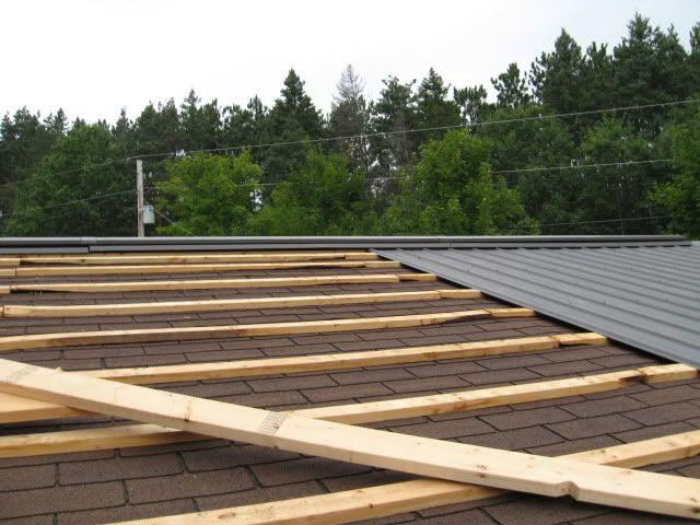

                        So On day 10, the first order of business was to cut and install new plywood sheathing over the new stud walls and insulation, and finish and re-wrap the original fascia returns.
                        And then move on to finishing the roof. First the fascia was made up of 2X8 cedar cleaned up with a light pass through the planer
                        Next I put up the 3" drip edge I had made up and then cut the steel at the valleys, and screwed it down, along with the original roofing I removed, and then added the ridge cap. Thats enough for another day

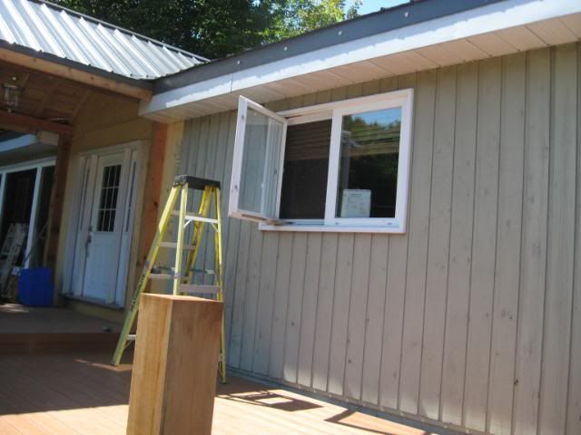

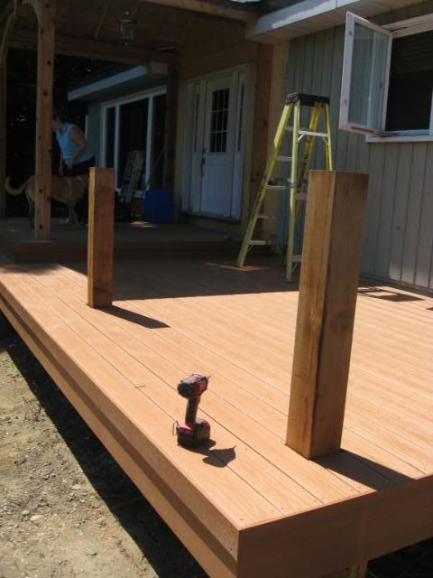

                          Day 11 was spent finishing up the lower deck and installing more Azek.

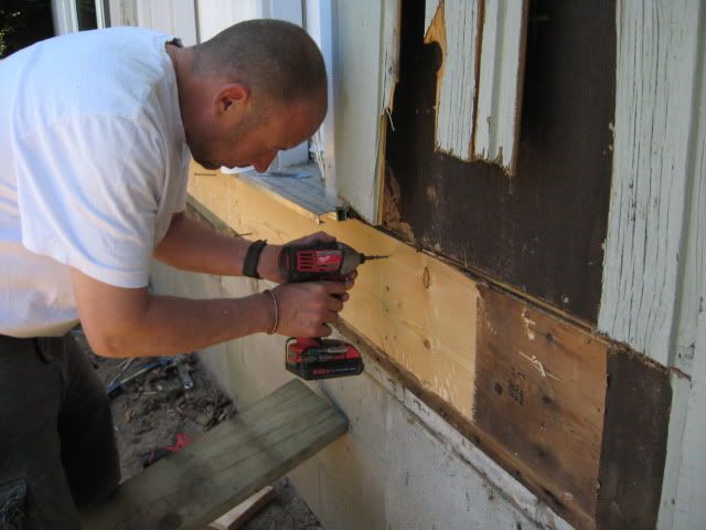

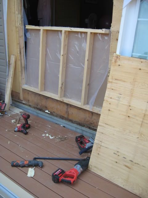

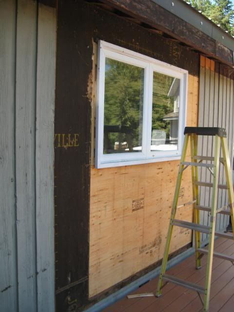

                          But then I got looking at that window.......
                          So I pulled the siding around it

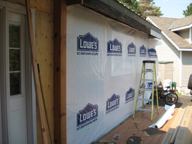

                          Then decided to leave it alone and started with housewrap
                          Then I changed my mind again and commited
                          That was it for the day. I tacked up some housewrap over the hole for the night, called Lowe's and ordered something to fill it, and got stuff ready for day 12.

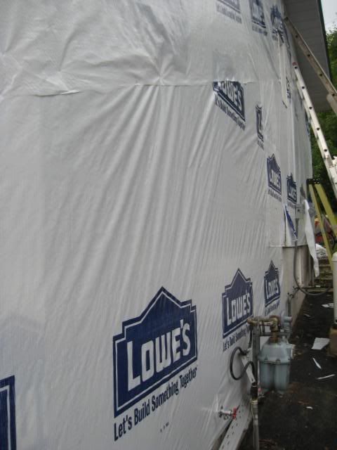

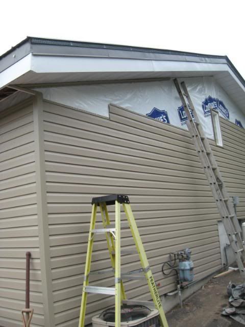

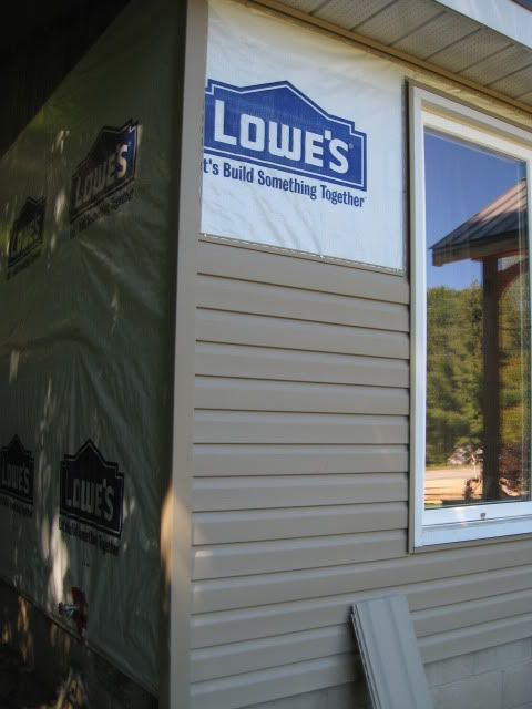

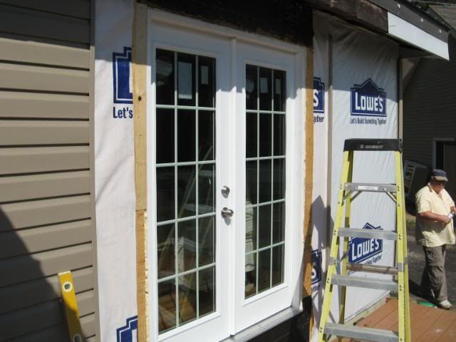

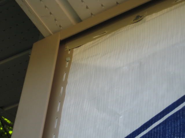

                            Day 12: Time to cover up the 70's cedar shiplap.
                            First step was to make sure the wall surface was releatively flat, and use a power planer to take off any high spots from the cedar curling over the years, and then wrap the entire structure in housewrap.

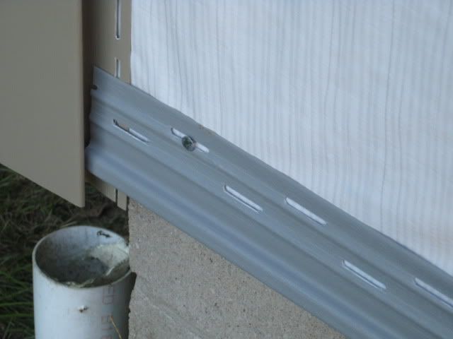

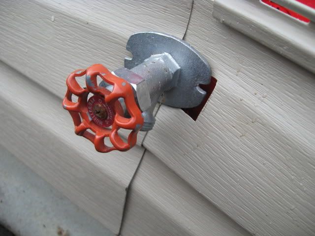

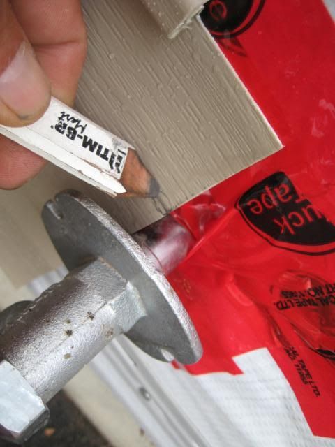

                            Then it was on to the siding. For this I chose to use Gentek siding in D 4.5 size, the colour is "Pebble Khaki" (same as my shop)
                            I began by installing the corners, Starter strip and J-mold
                            And started installing the siding.
                            Then the truck showed up with "hole filler" for the bedroom wall. So I cut out the existing stud wall right down to the floor, added a double layer of roofing paper over the sill and a few lines of sealant
                            And filled the hole
                            Then it was back to siding for day 13

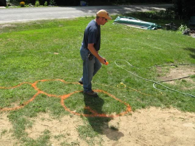

                              Day 13 stared with a visit from my friend, Jeff Argue. Jeff is one of the best landscape contactors in the business, and I am more than thrilled that he has agreed to help with the landscaping portion of this build. Jeff specializes in integrating both natural and man-made materials into a landscape, and he's also a horticulturalist, so he's going to do a planting plan for me as well. Here's a scan of the front of his card to give an idea of his "style". This should blend really well with the overall style of the reno.
                              Anyway, he got out his can of orange paint and we started marking out exactly what, where, and how the landscape was going to be done
                              With a plan laid out we called Atlas Block and ordered up the materials...they should be here in a day or two.
