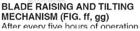

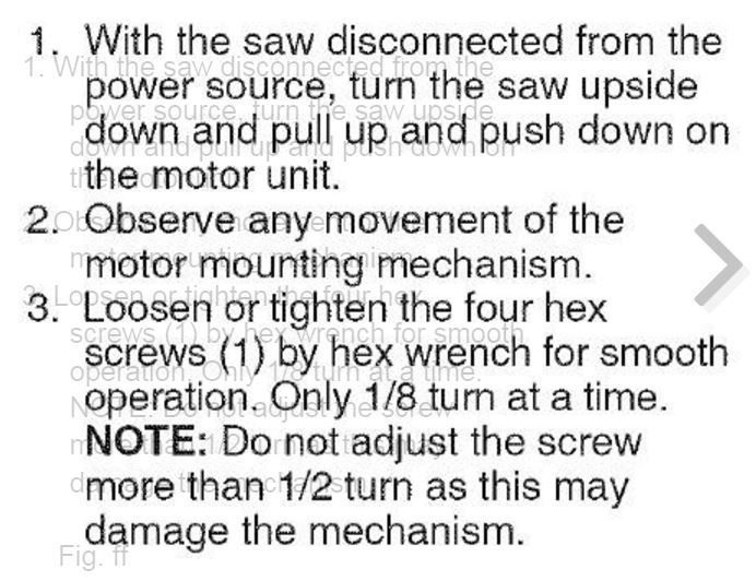

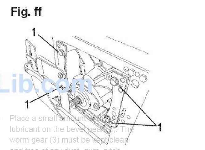

                  found this on page 43 of the manual.
                  manual
                  http://www.manualslib.com/manual/376...page=43#manual
