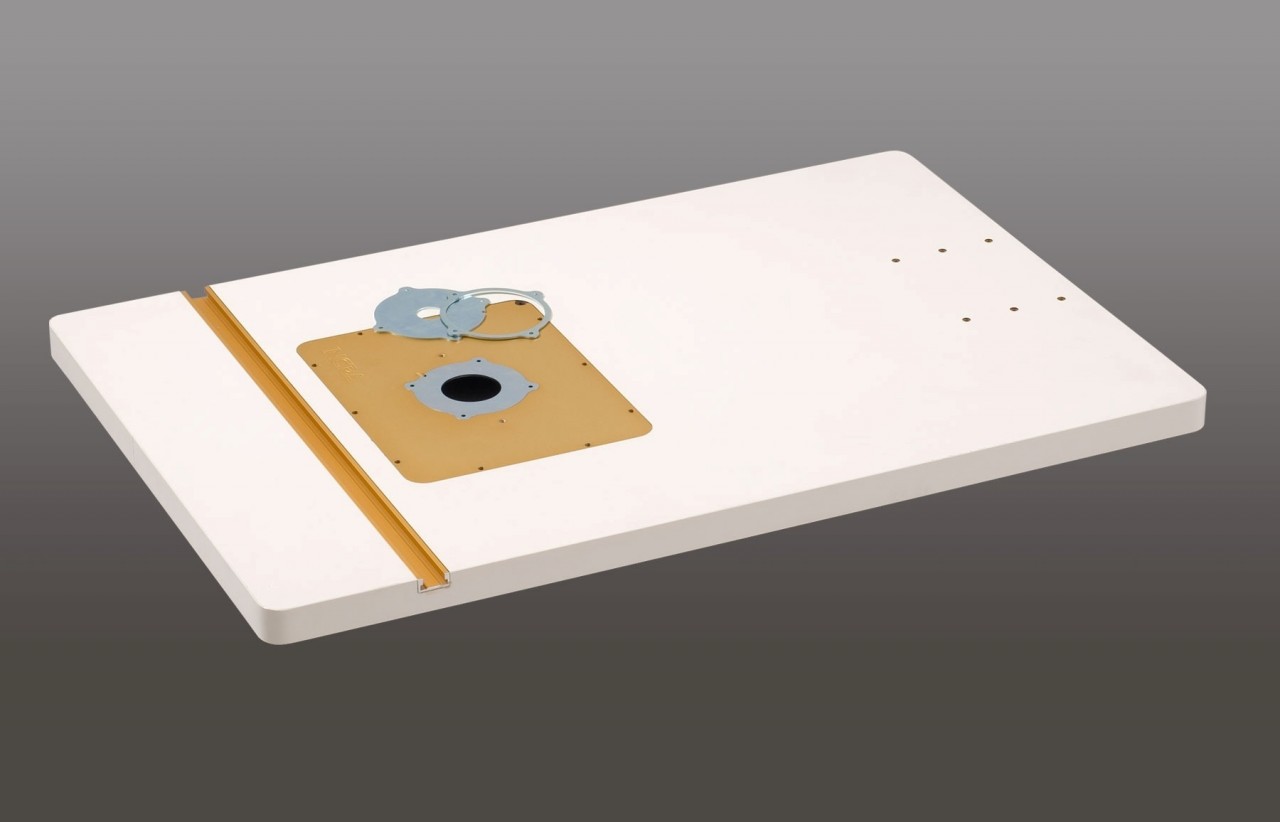

    A long time ago I had asked whether I should just sell my tools since I hadn't touched them in couple of years. even that question I believe was asked 4-5 years ago. So all my tools sat in my basement for all these years until couple of months ago when we decided that within next year or so we will be finishing our basement. So I asked for help from our local handyman and with his help added extra power outlets on different breakers in garage. I added 2 x 220v 20amp on one breaker, 2 x 110v on 1 breaker & 2 x 110v on 1 breaker total. All my tools are on 110v so idea was that I would have my dust collector and one more tool ( bandsaw, table saw etc ) each running on different circuit. 220v is specifically for my compressor whose motor cannot be switched to 110v. right now, except for dust collector, jointer and router table everything has been brought up from basement. I think I am going to need some help with jointer & dustcollector.
    Which brings us to Router table For all the years my router table had been 2' x 4' sheet of MDF on 2x4 dimensional lumber legs. Althought it did serve it's purpose I think it's time to retire it. It will also help me get reacquinted with my tools ( mods, given my skill level, if this should be in new woodworker section, please move it and I will continue posting in that area ). Most router table designs I have seen tend to mount router in the middle of the table top. I will be using my router table with both standard shop built fence as well as incra joinery fence I have. so I decided to build a table that mounts router plate towards one end. Table also needs to have drawers to store all router accessories I have. So I got ecabinets out and did a quick design. this is what I have so far. Few things to note..
    * All joints were set to be butt joints in ecabinets software so that I could use biscuits to do the joinery.
    * three of the small four drawers on side will require extra 1/2" panel that is cut in same dimensions as 1/4" drawer bottom in cutlist. this panel will have 1/4" lip all along it's sides. it will fit just like drawer bottom in a 1/4" groove that will be set 1" above drawer bottom groove. one of these panels will have 1/4" thru holes drilled on 1" X 1" grid to hold 1/4" shank bits upright. second panel will similarly have 1/2" holes drilled for 1/2" shank bits. third panel will have 1 3/16" holes drilled to hold all my template guides.
    * Top will be made out of 2 layers of standard 5/8" MDF with white laminate on top.
    * Door on section which holds router will have middle panel of acrylic with holes drilled in to make sure there balanced air pressure ( right term? ) to offset dust collector suction.
    router_table.jpg shows what finished router table is expected to look like. router_table_exploded.jpg is exploded parts display with one side set to transperent.
    Tomorrow I will check what I have by way of sheet good in inventory and start the build.
    router_table_parts_cutlist.pdf
    router_table_parts_layout.pdf
    --Rajiv

    I would add two mods to your cabinet. For one, unless you want to go with a router lifter I would mount the table top on hinges and hook up some kind of support to hold it at an angle so you can change bits in table and make all your adjustments with the table at eye level. I built this feature into my table and love it. Your idea of moving the router off to one side is a good one. You always seem to need to do a large project at some time or another and having extra table to support it is always appreciated.Are you going to install T-track in the table top? Very useful for hold-downs,feather boards and other jigs and can also be used for a mitre gauge.

    I am still toying with the idea of Jessem router lift. I have bosch router with two bases. right now, fixed base is permanantly attached to router table baseplate and router can be removed from base and set on table to do all adjustments. I will definately have a T-track on table top as well as on standard shop-built fence to attach feather boards etc.

    Couple of suggestions: Add a mobile base. Locate the router towards the front of the table leaving room behind the fence for micro adjustment mechanisims, center the router instead of towards one end of the table so as not to impair support for longish work pieces. Cut down on the number of drawers unless you really like making drawers.

    Quote Originally Posted by Lee Brubaker in Edmonton View Post
    Lee
    Hi Lee,
    No mobile base. but router table will have locking casters attached to bottom. Router will need to be towards one end of table due to nature of fence I am using with this table. Althought this image is not of a top I am building, it should give you fairly good idea of how my table top will look like. Incra fence I have has 18" travel. http://www.carbideprocessors.com/pro...99663_zoom.jpg
    --Rajiv

    The Jessem lift is a good one and it will allow for bit changes above the table with normal wrenches so it's a darn good investment.
    The miter slot is unnecessary for me and requires another setup procedure to get the fence absolutely parallel to the slot. If you're going to use it only for feather boards I would forget about it. There are other ways to secure feather boards.
    My router is on the right side of my table saw which is longer than most. Close to 7 feet. With the additional size and the ability to move the fence from the left to the right of the router I can use a foot and a half for support one way and 5 and 1/2 feet the other way. I know lots of guys don't like the idea of a router table in an extension wing of the TS but it works great for my stuff.

    So looks like I mostly had 1/2" and 1/4" sheets in basement. nothing in 3/4" thickness. caracass of table is going to be 3/4" ply. HD usually carries paint grade maple ply. all I needed is one sheet. drawer boxes are all going to be 1/2" thick. Today I finished breaking down the 3/4" ply into parts for table. paused to snap a picture ...
    Now time to break out biscuit jointer and start the assembly. Current plan is to finish caracass, put the top on and then use that setup to make drawer boxes. Hopefully I will finish basic router table ( sans the drawers ) this long weekend.
